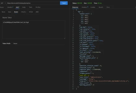

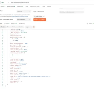

Can't make it work with Postman. I will need to debug more and add custom code to see and probably upgrade external libraries to newer versions. Thanks.

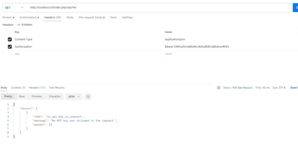

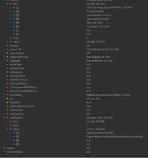

I traced the code, right after I call the endpoint , I got a http 400.

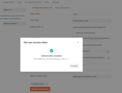

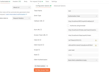

This is my config on postman locally
On postman, it always says I need api key
Still don't know what I did wrong, Postman says I'm authenticated and copy paste the token
Did you check your webserver config?
The Authorization header might not be passed to PHP.
If you use Apache you could try to add SetEnvIf Authorization "(.*)" HTTP_AUTHORIZATION=$1 to .htaccess

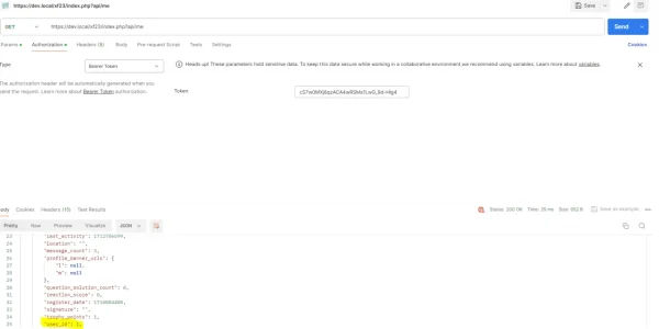

I nailed it down , it's working now with postman, I have to uncomment this line in .htaccess
RewriteRule .* - [E=HTTP_AUTHORIZATION:%{HTTP:Authorization}]
