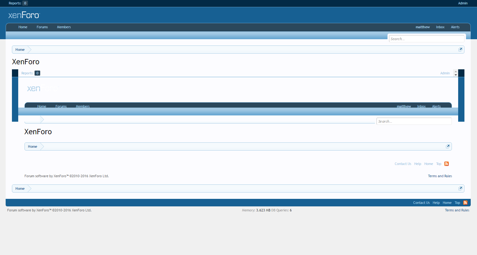

Hey everyone, I've been trying to figure this out. I'm using this package in my Laravel 5 application for bridging XenForo to Laravel. All is fine. It's just...templating.
It always messes up. I just...I can't figure it out. Here's the function that's called on...here's the function eventually is called on.
It's calling on XenForo_ViewRenderer_HtmlPublic, so obviously I don't quite understand what's going on here...
Here's what it looks like by default...

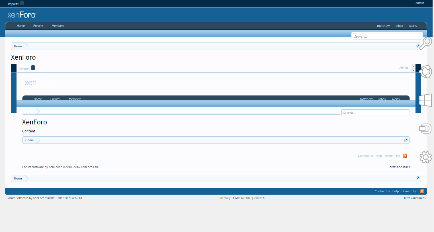

Here's what it looks like when I add 'Content' as a the content parameter.
Even when making a custom template, nothing seems to work quite right...

Also what xenforo template are you trying to render. It looks like judging from the screenshots you are rendering the PAGE_CONTAINER template within the PAGE_CONTAINER template. I just happen to open up the file right now and see that that I have added an additional parameter to the method signature called $container which is not included in the doc block. If you used the default values of $name and $container I suspect that is what you are getting above. I use the bridge to render other xenforo templates into the PAGE_CONTAINER and do not rely on the default template name in the signature anymore which may be why I had not come across this bug.
