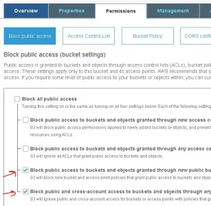

everything seems to be working as far as i can see from the xf side but i'm getting the 403 on the write to s3. I'm struggling with applying the policy to the bucket. I've made the bucket and the IAM but i can't figure out the correct way to attach it VS the public/private bucket selectors.
Is there a quick ref guide to help guide me? I ran the instructions 4 times and i'm still broken so i'm not getting it... I realize this is a bit outside of supported realm here...

This permissions setting work for me, it will change the access status to "Objects can be public" (The bucket is not public but anyone with appropriate permissions can grant public access to objects.)
Thank you! This was my issue as well.
