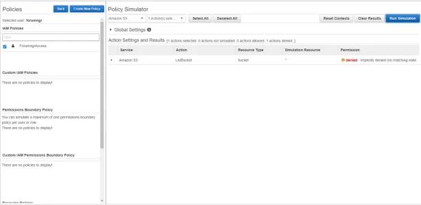

The stimulator is also reporting denying permission with the s3 bucket.

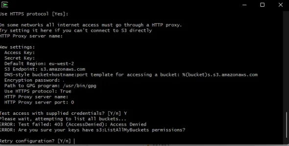

S3cmd throwing this error on config -
Thought that the s3:ListBuckets permission from the json should cover it?
There is no such permission as 's3:ListBuckets' - there is "s3:ListBucket" - and "s3:ListAllMyBuckets"

Sorry, I mean 's3:ListBucket'.
Just don't know why the permission is denied.
the simulator is looking at '*' in "simulation resource" - ie any and every bucket. You (rightly) have probably restricted actions to your actual bucket. the simulator tool is a waste of time IMHO.
Thanks, but I use the stimulator because I was getting error in the s3cmd config.
The error is strange because my I AM user should have access to all my buckets.
This is why I dont like s3cmd - you dont actually need s3:ListAllMyBuckets for XF to work. Anyway either your perms are wrong or your using the wrong set of creds? Incidentally if you are running this on an ec2 instance, you shouldn't even be using an IAM user
I agree, even amazon advised users to remove ListAllMyBuckets and replace it with ListBucket.

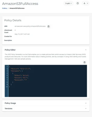

I'm trying to set up Wasabi on my testing XF (they have a 30 free trial without the need of credit card details) to see if I can buy their service and attach it to my live XF.
Steps are slightly different from Amazon S3 but I think I can manage it.
For the moment I'm just stuck to the policies creation, and this is why I'm posting.

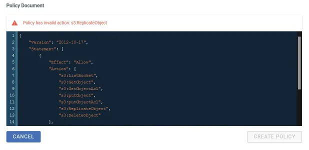

When I paste the full JSON code in their "Policy Document" field, I get Policy has invalid action: s3:ReplicateObject error:
1648291293597.png​
I don't know if this is a Wasabi servers limit or if this action has been removed by the time the guide was written...

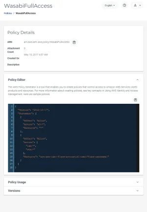

Anyway, they already have 2 "FullAccess" policies: AmazonS3FullAccess and WasabiFullAccess.
Would it be ok to select both of it for setting up the bucket policies to work with XenForo?

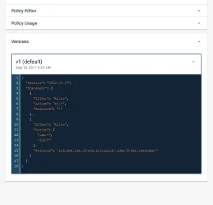

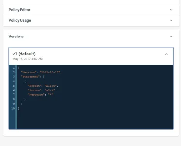

Here is how it's set:
1648292193065.webp​
I'm not going to comment on wasabi - its a third party and you use at you own risk -although as there are no deny statements, it wont affect anything. As for Amazon s3FullAccess - if you ain't storing any other data in the account, then you are probably ok. If you get breached, they can take all your s3 data and wipe everything - if, given the likelihood of this is happening and the impact it causes and you accept that risk, then all good.
