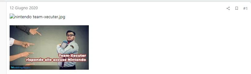

I have a forum where I configured S3 storage like this:
https://xenforo.com/community/resou...or-amazon-s3-for-file-storage-in-xf-2-x.6805/
PHP:
$config['fsAdapters']['data'] = function() use($s3)
return new \League\Flysystem\AwsS3v3\AwsS3Adapter($s3(), 'cdn.**.net', '/forum/');
$config['fsAdapters']['internal-data'] = function() use($s3)
return new \League\Flysystem\AwsS3v3\AwsS3Adapter($s3(), 'cdn.***.net', '/forum/');
$config['externalDataUrl'] = function($externalPath, $canonical)
return '//cdn.***[B][I].net/[/I][/B]/' . $externalPath;
I manually moved all content to S3 with public permissions, and if I upload a new attachment to a discussion now it works. But I'm having a problem. All old attachments are not visible.
Esempio:
As you can see, the first attachment that is not visible is the old one, while the second is what I added by doing:
Edit Message -> Add Thumbnail
Why are all the images not visible? a tool for reconstruction?
As I said, I uploaded the files to S3 and set the permissions, in fact if I edit the post and put the thumbnails it works correctly.
But the old link, before I set up the S3, the link stays like this, without S3:
HTML:
<div class="bbImageWrapper  js-lbImage" title="2nc0vuh.jpg" data-src="https://www.**.com/forum/attachments/2nc0vuh-jpg.23006/" data-lb-sidebar-href="" data-lb-caption-extra-html="" data-single-image="1">
        <img src="https://www.**.com/forum/attachments/2nc0vuh-jpg.23006/" data-url="" class="bbImage" data-zoom-target="1" style="" alt="2nc0vuh.jpg" title="2nc0vuh.jpg" width="300" height="300" loading="lazy">
    </div>
if I edit the message and select the attachment, he puts it with:
HTML:
<a href="https://www.**.com/forum/attachments/psu-ps4-jpg.9845/" target="_blank" class="js-lbImage" data-lb-sidebar-href="" data-lb-caption-extra-html="" data-fancybox="lb-thread-82679" data-caption="<h4>Psu ps4.jpg</h4><p><a href=&quot;https:&amp;#x2F;&amp;#x2F;www.**.com&amp;#x2F;forum&amp;#x2F;threads&amp;#x2F;ps4-si-accende-e-subito-si-spegne.82679&amp;#x2F;#post-837213&quot; class=&quot;js-lightboxCloser&quot;>Brek · 17 Febbraio 2016 alle 20:44</a></p>" style="cursor: pointer;"><img src="//s3.**.net/**/attachments/6/6888-55e9062232a5d5f04ce164f5c1e36d0f.jpg" class="bbImage " style="" alt="Psu ps4.jpg" title="Psu ps4.jpg" width="256" height="160" loading="lazy"></a>
As you can see, the attachment in the PRE-S3 message has not been changed...
In your example above you're using "s3..." URLs for your attachments but in your posted config.php changes you're using "cdn..." URLs.
Are you actually using a CDN? If not, your config.php file should use the "s3..." URLs.
