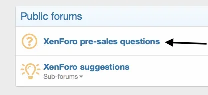

As an example say I want to change the color of this text:
  • What area/window of the Chrome Inspector should I be looking in to find the proper CSS code to search for in the XF ACP templates to do the modification?
  • And in this specific example...what is the exact code I should be looking for to use as the search term for the XF ACP template search?

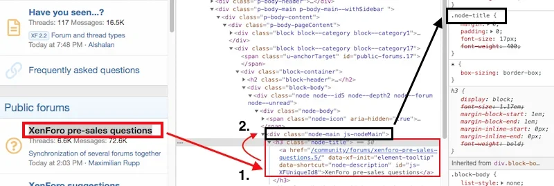

So, now you go to extra.less and put this in it:
.node-title a { color: red;}

I think the part I assumed (wrongly)...was when using the Chrome Inspector...the code that shows up for the page item that was right-clicked...the code that's highlighted (1. in my image) in the Elements window...is the proper code to then look for the CSS info in the Styles window.
It looks like in this case I needed to go up one line in the Elements window (2. in my image)...and then get the proper CSS code in the Styles window (in this case .node-title).

I noticed that in the code you provided for the extra.less template...you added the "a"...to make the CSS .node-title a
Is the "a" necessary to make it different than the original template code for the .node-title? Or does the "a" in the .node-title a code from the <a href= statement?
2nd question. I see I would be adding the code to the extra.less template. Just curious...why wouldn't I want to edit the actual template that contain the .node-title code for this node...rather than adding code to the extra.less template?

You're styling a link, that's why the addition of the lowercase "a".
I wouldn't recommend doing changes to core templates unless you are pretty sure of wut you're doing. I recommend you do your modifications in style properties and in extra.less until you get comfortable with the software.
