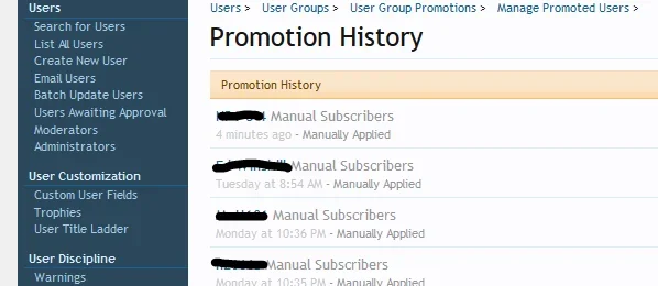

I'm struggling with that. Is it on 1.4? I was actually looking for that functionalty outside of this issue but couldn't find it.

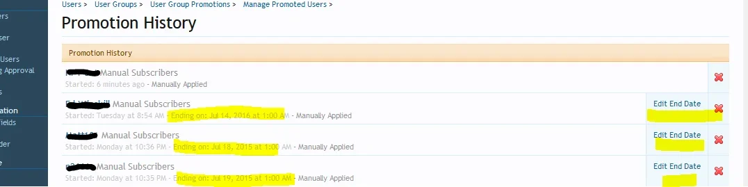

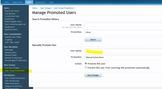

Nearest I can find is this. I already had manual subscribers set up but it give no option for end dates. That's why I have Promotion End Dates by Waindigo installed
With add-on
It's under User Upgrades
On the User Upgrades page, click on the controls next to a user upgrade and you can see the manually upgrade user option there
Then just specify the user you are manually upgrading and when you want the manual upgrade to end.
