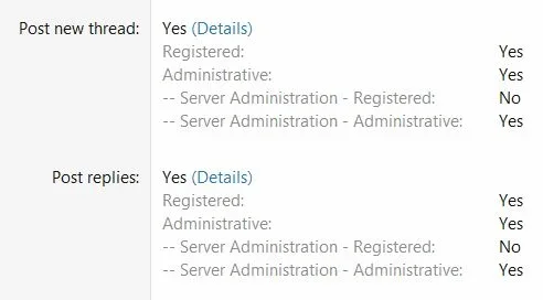

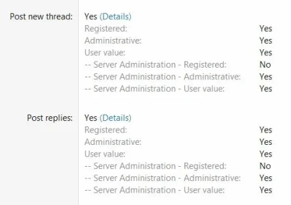

I then used the permissions analyzer and entered Tourmeister as the user and Server Administration for the node.
Server Administration Permissions for Tourmeister
191249
Permissions for TestMule Superadmin
191250
For the life of me I cannot figure out why it works exactly as expected for the Testmule account but not for my Tourmeister account. Nor can I figure out why it matters whether I am replying to old threads imported from vB or new threads posted by TestMule versus a new thread posted by Tourmeister!?
