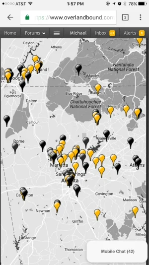

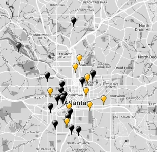

Ok, I'm working with the ACP settings and adjusting "Duplicate placement area" to try and avoid overlapping pins. I'm going for a nice distribution where folks are not hidden. Try as I might, I still get this:
With LOTS of people buried in the stack. Does anyone know a way around this?

What you've got is a lot of users putting Atlanta as their location. They'll pile on top of each other.
You could use the duplicate location field - what have you got the value set to? The distance from one side of Atlanta to the other is around 16 miles. If you set it that many meters it would spread them out.
It won't be perfect either because you're zoomed out. If you zoom in it'll declutter a bit but still be very dense.

Got it, thanks. I currently have "Duplicate placement area (meters)" set to 4,000. It seems like this may need a secondary parameter like "min pixels between pins". Which could then be set to 10 or 25. You probably then have strange things at low zoom, but perhaps the heat map settings would resolve?
The problem (might be) with that is it becomes quite expensive for the user and their machine. With a map like yours which is already pretty busy it could make the plotting quite sluggish. I need to get the point, plot it, look to see if it is duplicate, if so, find a random spot, look around there to see if there is another point within n pixels, if there is, find another random point etc. It could be a bit nasty for the browser.
I intend moving the hard work back to the server to save the client the grief of all this. There are a number of things which could be shifted back to the server now. This would be one of them. All this "hard" work would be done on your server and map the map a lot snappier than it is now.
As for your users in Atlanta, zoom in two clicks and it opens up quite nicely. They're not as overlapped as the screenshot you show.

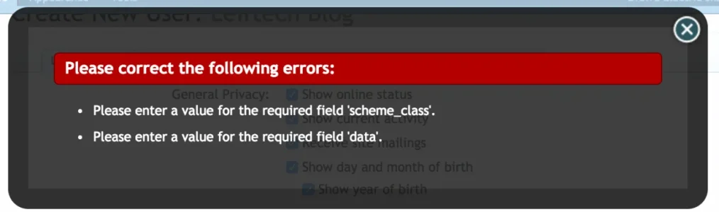

I'm getting this error when trying to create users manually in the ACP.
They go away if I disable this add on

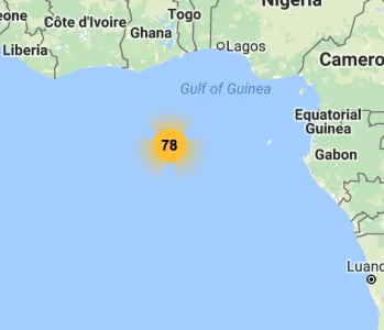

It seems lots of users aren't getting plotted in the right place anymore.
On lots of my recent registrations they have a proper location, as always, but when viewed on the map they all show in the ocean :confused: When I zoom in there's only every one pin point, but it's a different user each time I zoom out then in again.

If you enter the API key in the format below it will correct that incorrect ocean location (I had the same problem), but then when new people try to register it will give them an error that says the API has rejected them so you cannot use it. Using just the standard API worked with v3.6, but it got messed up in v4.0.
https://maps.googleapis.com/maps/ap...e+Parkway,+Mountain+View,+CA&key=YOUR_API_KEY

Ok, it seems some are having problems encoding the location. I cannot for the life of me recreate the problems (I've been working with Michael on this)
Some questions to try help:
  1. Do you have it enable on registration?
  2. Do you have Map Location or normal built-in location set?
  3. Does it happen with all users or some?
  4. Does it happen with only registration or are there other instances?
  5. Are there any errors in ACP relating to this?
If it's a google denial thing then there should be errors in ACP. if not, I am stumped while I cannot recreate it.
I'm putting in an addition now to log it. This should help diagnose things a bit better.
