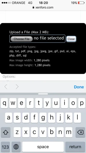

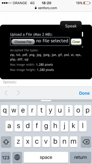

There is similar issue with the popup to upload files though. I usually cannot click on the 'close' button, I attached screenshots.
I had only been testing it on the quick reply, to be honest.
Maybe that's why I couldn't reproduce it, I will take another look, thanks for the additional info :)
I've still been unable to reproduce the originally reported issue, but we have made changes here specifically to fix the close button issue and I reckon this will generally help.
We now specifically blur the editor when the "Upload a File" button is clicked.
We'll roll this out here shortly if you'd like to test :)
