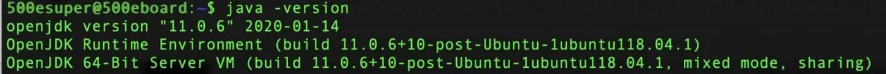

Following up on this for folks, if the issue comes up in the future.
My environment is currently Ubuntu 18.04.3, running XF 2.1.7, php 7.4.3:
When I recently updated my Elasticsearch 7.5.2 installation to 7.6.0, the system returned an error, noting that my current Java 8 installation would not work, and that a newer version of Java/JDK was required.
With Elasticsearch version 7.5.2 and below, you could use Java 8 and higher as the runtime environment. With ES 7.6.0 and higher, Java 11 or higher is seemingly required (at least, it was when I tried to update it on my forum).
This means that you must upgrade your Java environment (JDK) to Java 11 or higher. I did this by removing the Java 8 PPA from my Ubuntu list. It has not been updated since early 2019 anyway, because of Oracle’s licensing changes relating to Java. Java 11 is the latest LTS version of Java after Java 8, and Java 8 is no longer receiving updates from Oracle. I would not recommend using Java 9, 10 or 12, as they are not LTS (long-term supported) versions of Java/JDK.
I switched over to the OpenJDK environment and installed Java 11, by adding an appropriate PPA to my Ubuntu PPA list (also: see first command below). This works for Ubuntu, Debian and relates distros. Obviously things will be different for CentOS, RHEL and other non-Debian-based distros.
The commands to add the Java 11 OpenJDK PPA, and then to install Java 11, on Debian-based Linux distros, are:
add-apt-repository ppa:openjdk-r/ppa apt-get update apt install openjdk-11-jdk
The previous commands assume you are root. If not, please preface each command above with sudo
The URL that will appear in your PPA list to be checked with apt-get update && apt-get upgrade operations is:
http://ppa.launchpad.net/openjdk-r/ppa/ubuntu
After installing Java 11, and checking it with the command java -version you will find that ES 7.6.x will install just fine.

It wasn't an error. It was just a message that came up on the screen during the Elasticsearch upgrade that said it required a higher version of Java, and it refused to continue the install/upgrade of ES. I was using Java 8 Update 201 previously.
Java 8 is now fairly old and while still supported ..... it was more than time to upgrade anyway. Even Java 11 has been out for a year and a half, and Oracle has released several versions (non-LTS) well beyond that.

Yeah, I saw that support matrix (after the fact) and was surprised, given the very specific message that I received that stopped the install. It basically said that my version of Java was incompatible with Elasticsearch 7.6.0 and that I needed to upgrade.
After I did, I re-started the ES upgrade and it went fine. I wonder if it was one of the Java components that it didn't like. Maybe I'll send the ES folks a note and see what would have prompted that message.

Today I upgraded from elasticsearch 7.6.0 to 7.6.1, and received this message. This is the same message I received earlier. So I mis-read it -- 7.6 is still working with Java 8, but they are warning that it won't in the future.
Although I'm running on Java 11, it looks like I haven't excised all of the old Java 8 files from my system.
