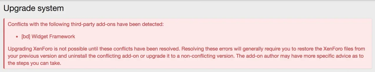

Tried running the upgrade, and got this:

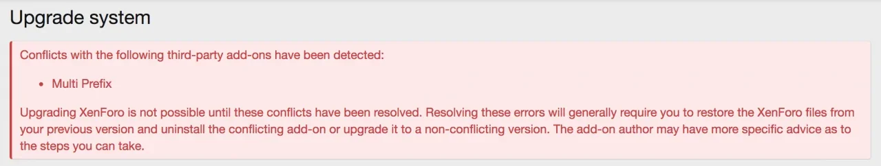

So I reverted the files back to the xf1 files, removed that add-on, tried again and got this:
I don't see any reason for this -- the code does check all of them before returning a result. Not only that, the widget framework check happens before the multi prefix check, so if anything, you should've gotten that one first.
I might've take/posted the screenshots in the wrong order because I did leave the tab open and reopen the process in a separate tab and then took the screen shots after I went back for both, but it definitely happened for some reason. Will try the upgrade again later to see if I can reproduce it again
