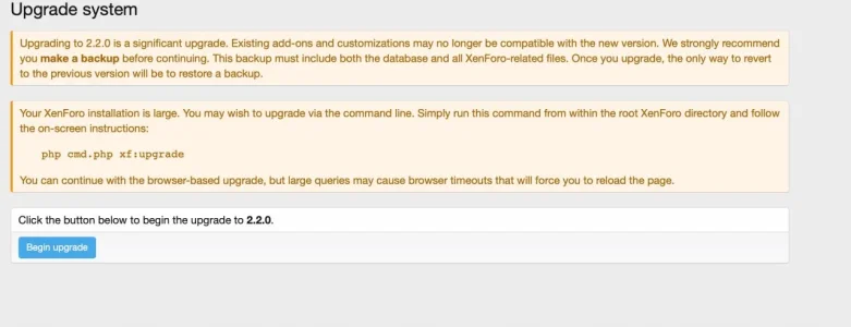

I started the upgrade to be told the site is too large and it reccomended updating via cli from the root directory using comand php cmd.php xf:upgrade
The error returned is: PHP 7.0.0 or newer is required. 5.6.40 does not meet this requirement. Please ask your host to upgrade PHP

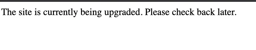

The forums are closed as the admin portal in gui is reporting that The site is currently being upgraded. Please check back later.
