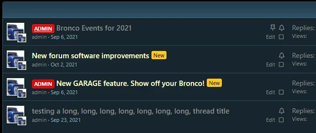

I made a custom style and somehow I've managed to set it so all thread titles are bold, whether they have been visited or not. I want the unread titles to be bold, but the visited (read) titles to be normal weight, just like it is in the default style.

Yes, I definitely have unread threads. But I appreciate the suggestion because I've certainly been known to miss the obvious before. :)
So when I tried to control it via extra.less I get mixed results. For a:visited I can control the color, but I can't control the font weight.
Here's the CSS I've added to extra.less. The font-weight: normal !important just doesn't affect the visited links for some reason.

Thank you. Removing the "a" did help, but in a strange way.
I removed the "a" and then changed the font-weight to "normal" and that did it. So by default the unread thread titles are bold and I was actually making everything bold by trying to override it. I still don't quite understand how, but the following code works. I got rid of the "visited" portion all together.

I do want it to act as default (bold for unread, normal for read). But my style was showing bold for all thread titles, regardless of whether they were read or unread.
