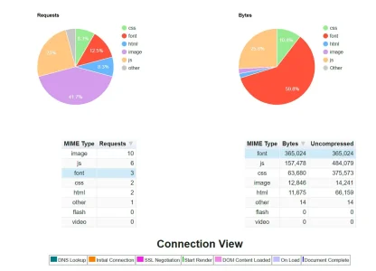

I'm confused with this font awesome thing, too. And very unhappy about it. Font - 60%!!!
Why do all visitors have to download 3 huge wont files? Why every page has to load several times slower when only one visitor out of a million takes care if font is "regular" or "solid"? Please explain.
