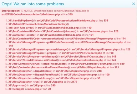

Is anyone else getting the error on the screenshot below when trying to post a new thread/reply in Xenforo 2.1.1?
It's a Vanilla installation with 1 add-on installed (Amazon S3 add-on).
Note: I am unable to replicate the error in a test thread here at the official Xenforo forum as well as at a Xenforo demo site.
Thanks for your time.

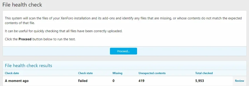

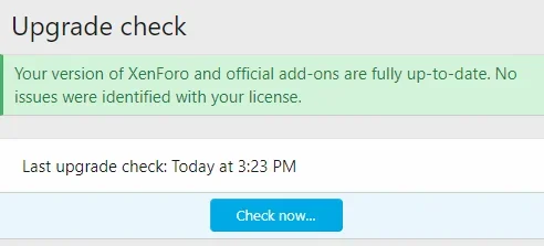

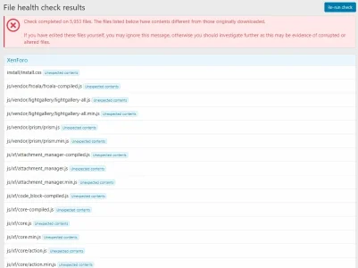

Is 'File Health Check' supposed to look like this? (Considering that we upgraded from 2.1 to 2.1.1 today)
It would seem that the installation didn't complete correctly. More specifically, it looks like the files were not fully uploaded.
You need to re-download the XF 2.1.1 files, re-upload them to your server and then verify that by re-running the file health check, it passes successfully.
Once you have done that, go to the install URL, log in and click "Rebuild master data". This will re-import any master data, including missing options which is causing the error in your OP.

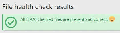

The file health check was fine after we re-installed 2.2.1.
Unfortunately the error in my first post persists when trying to post a simple word ('test') in existing topics that we were able to post in before the 2.2.1 update.
