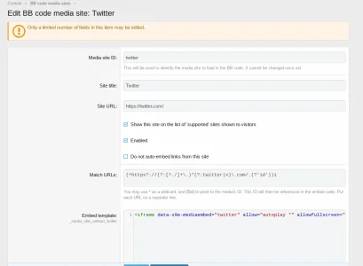

It looks like Twitter (now X), is having new post come from X.com instead of Twitter.com, this is now breaking auto embeds. Anyone have a fix, or so we have to wait for an Xenforo update?
Hmm it's not that. There's something else going on.
If I make an exact copy of the twitter media site, name it twitter 2 and disable the original, the new one doesn't work (ignoring the whole x.com thing temporarily).
Does something get cached somewhere that could be causing an issue?

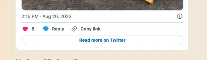

Using a shared link from Smoking Pipes on Twitter desktop website (which going to X.com redirected me to) and posting it in my site using bone stock BB media code, I got this.
I also found this rather amusing. Tells me to read more on Twitter... not X.

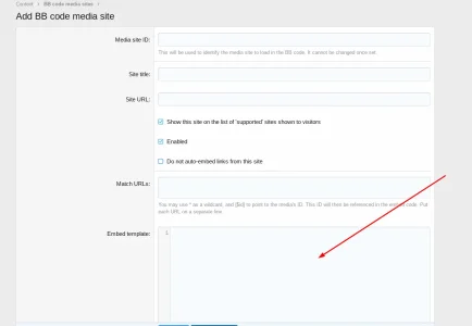

I would like to get what you posted for the subsequent boxes
Match URLs:
x.com/*/status/{$id}
x.com/statuses/{$id}
twitter.com/*/status/{$id}
twitter.com/statuses/{$id}
Embed template:
<xf:page option="jsState.twitter" value="{{ true }}" />
<xf:js src="xf/embed.js" min="1" />
<div class="bbMediaJustifier bbCode-tweet"
      data-media-site-id="{$siteId}"
      data-media-key="{$id}"
      data-xf-init="tweet"
      data-tweet-id="{$id}"
      data-lang="{$xf.language.language_code}"
      data-theme="{{ property('styleType') }}"
      ><a href="https://twitter.com/i/web/status/{$id}" rel="external" target="_blank">
    <i class="fab fa-twitter" aria-hidden="true"></i> https://twitter.com/i/web/status/{$id}</a></div>
Match URLs:
Embed template:
Thank you, that worked great (y)
