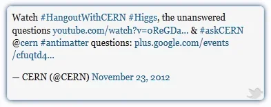

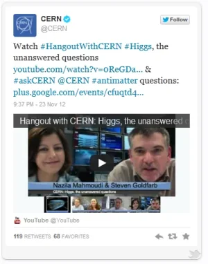

Yeah I did that before as the fallback...like before twitter.js adds all of the styling and crap...i was playing with it and liked it..also thinking that if someone has the same background color as the tweet...it will just bleed into the page and look stupid imo...this adds separation.
Before the twitter js does it's thing, the info from the tweet would look all crazy, so my css at first only was intended to wrap the content and keep it from going crazy all over the place like this
I had expanded that further for if someone doesn't use js but it would be too much of a pain in the ass to support as it would need MAJOR changes even when the twitter response only changes it's formatting a little so I left the one I am sharing with this basic preforming of the element.
What I did when i just fixed that gigantic space in the tweet was add some padding to the border on the bottom and placed that same little twitter logo there like this...
for those that want to remove the border...
just remove the padding from .twitter-tweet {} in template: bbms_twitter_css

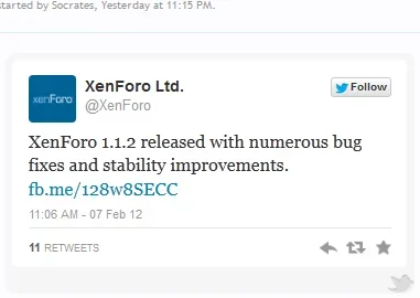

Weird. Installed this but doesn't seem to work.
When I try to embed a tweet it just shows a blank space.
I assume once it's installed this is what I should see?
All that seems to happen when I use it is it places <div class="tWwrapps"></div> in the post.
