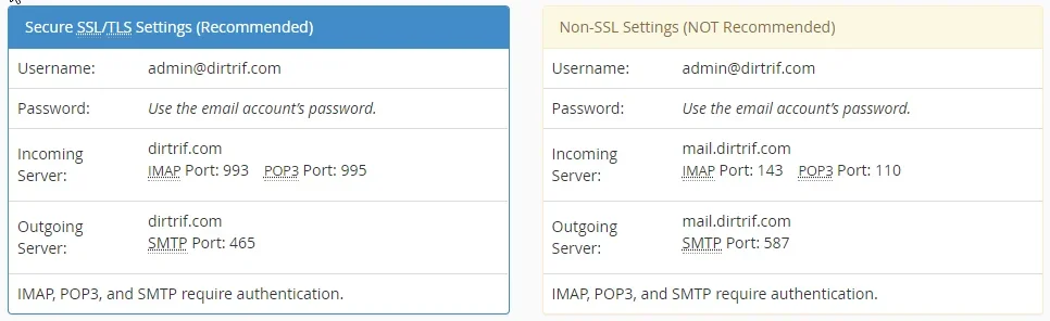

To setup SMTP mailing GoDaddy provides you with all the details you need to setup and have everything functioning, with this handy bit of information:
...Yeah, so that's no help I did all that and nothing is working! It's ok I got you covered
So what you're going to want to do is get to your godaddy cpanel, once there you have a really long URL in the address bar. Go ahead and copy that bad boy. Now lets pluck away at that URL you just grabbed. you can loose the https:// then keep everything up until the :2083 (I'm assuming this is the same for everyone, but if your numbers are different don't worry just up until your numbers and follow along.)

You follow those steps you should be all set and have no problems with email sending.
