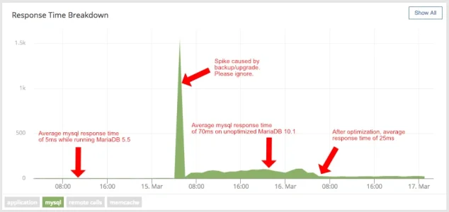

One of my Centmin Mod users who runs a Xenforo forum clearly highlighted that point when he accidentally removed Centmin Mod's auto tuned MariaDB MySQL settings which is done on initial Centmin Mod installs automatically based on detected server processor, memory and disk resources available and based on my 20+ years of optimising vBulletin and now xenforo forum's MySQL performance. On removing the optimised MariaDB configuration settings, his forum and MySQL performance measurably dropped from his monitoring and charts he posted at https://community.centminmod.com/threads/mariadb-10-1-slower-after-upgrading-from-5-5.14254/ saw 14x times slower response times!
His chart
You can see the difference after he restored the automatically tuned MariaDB config settings here https://community.centminmod.com/th...er-after-upgrading-from-5-5.14254/#post-61092.
  • MariaDB 5.5 preupgrade with auto optimised config = 5ms response times
  • MariaDB 10.1 upgraded removed auto optimised config = 25-70ms response times
  • MariaDB 10.1 restored auto optimised config = 5-10ms response times
Yes we're measuring in milliseconds but that could be all in takes for MySQL response times under high concurrent activity load. The user did say he noticed the slowness browsing his forums though as forums aren't made up just a single MySQL query.
