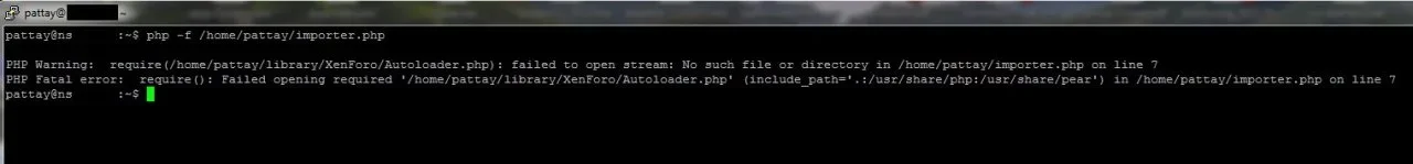

I tried every path to the file. Nothing works.
the correct path is /home/hobbymac/public_html/importer.php

But here is the screenshot if i run your script.
As you can see i can access the file and try to let it run.
The error came only from missing files in the xenforo installation. And that should be ok.

"Unexpected error occurred. Please try again later" is an error returned by XenForo (same happens when clicking the link above), so accessing the script through the CLI is working fine, it is just the script is producing an error.
Correct!
