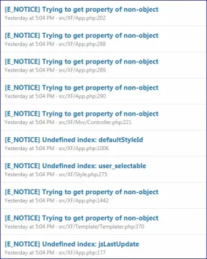

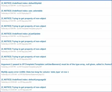

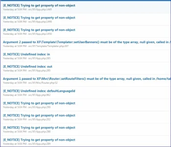

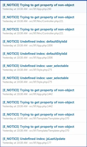

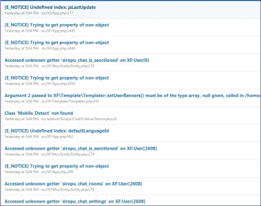

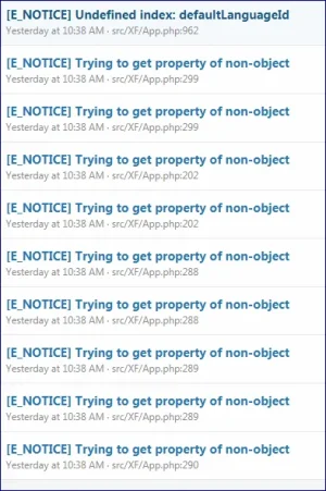

I don't know what daemon attacked my site yesterday at 5:04PM and 10:38PM, but I received hundreds of server errors of different types.
I am sort of lost about what to do with these (many a time I was just about to hit "clear all" out of agony), but then I thought okay let's just post it in XF to see if anyone can make any sense out of these.
FYI, I use Chat 2 and Content Rating addon (and I haven't changed/installed anything new in the last couple of days). My PHP is 7.0.
I exclude the detailed error log in this post as I don't know what to take and what to leave, but I can post if anyone wants.
