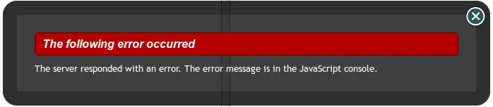

Hey thanks for the reply,
My problem is that I have everything like you said, like the AutoValidator or data redirect tag, but it's throwing a JS error :
The JS error message is above on post #1.
Is that all that's in the console? Doesn't look like an error to me.
Just a thought: Make sure you've not got anything that could modify the output of the form action...
e.g. If you have anything like echo, or var_dump or Zend_Debug::dump then it may very well generate an error (as it breaks the json output).
Aside from that, a javascript error message can come up due to some other reason. Check closely for syntax errors etc.
Check out this :
It it's the Javascript Console (error).
Don't you think that ?> is strange at the begining ?
hm actually, yeah that doesn't quite look correct.
As I say, you've probably got a boo boo in your code - whatever code is running when the form is submitted.
Possibly even a missing close bracket }
