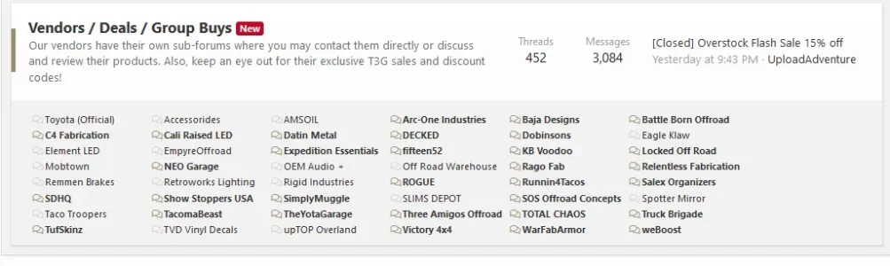

Try adding that to Extra.less and see how it looks! I don't have any sub forums so I can't test it, so feel free to tell me and I can try sort it out bit better!

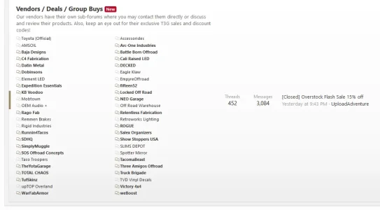

Possible to make it 4 columns instead? And, where can I add the node ID so it only does this to this node?
Would it be possible to create a little link that says "Click to expand the vendor list" and when you click it, it shows all of them, without reloading the page?

I got it working properly. That was my fault.
Now I'm going to try the one @Russ linked.
@Russ

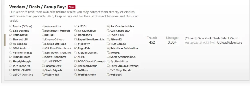

Not bad!
A few issues though.
One, it looks like there is room for one more column but changing the width % doesn't put that extra column in.
It does change all of the sub-forums, thus making the forum list even longer, which is the opposite of what we want:

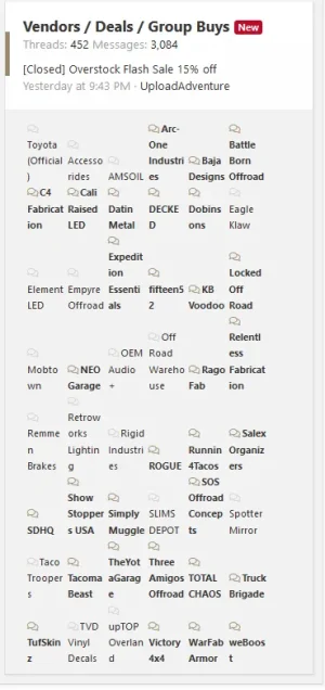

This doesn't work in smaller views at all:
Did you resize your browser window or load it with the correct width settings? The template CSS specifically hides the list in narrow views.
It can be done but will require some conditionals to the edited templates. Im not at my desk at the moment so not much help there.
