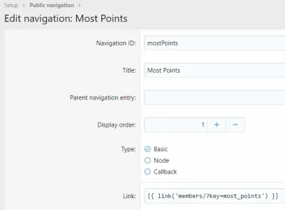

I can add a new public navigation with the type:
  • Basic
  • Node
  • Callback
If i use BASIC and and enter a Link, how can this tab be marked as selected?
I want to add e.q. Current Visitors as a tab, and used "{{ link('members/&key=most_points') }}"

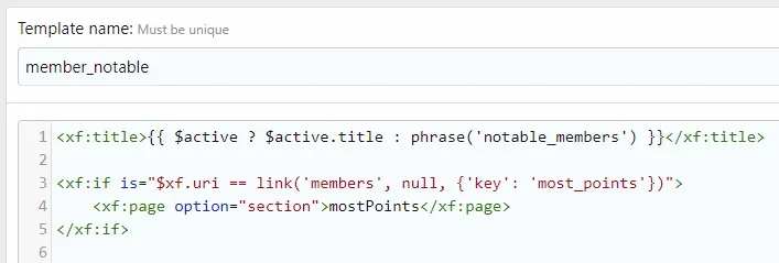

Assuming you want the tab to only be highlighted for most points and the default Members tab to be highlighted at other times, you would need to edit the member_notable template and add this after the first <xf:title> line:
HTML:
<xf:if is="$xf.uri == {{ link('members/?key=most_points') }}">
    <xf:page option="section">navID</xf:page>
</xf:if>
Replacing navID with the actual ID of your nav tab.

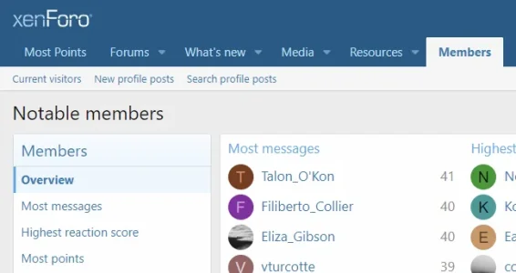

Thanks, this is much appreciated, but it is not working.
The members/&key=most_points was just an example, it could be anything else.
I add a navigation route called MemMost and used basic and add the link into the link field as mentioned above. If I know click on the new created navigation tab the page :Most points" will be opened but the tab is still not selected, it is still the members tab which is marked as selected.

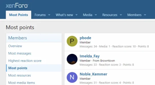

I can confirm it works.

You're not using friendly URLs so use this instead for the conditional statement (it's a more valid approach anyway):
HTML:
<xf:if is="$xf.uri == link('members', null, {'key': 'most_points'})">
    <xf:page option="section">mostPoints</xf:page>
</xf:if>
