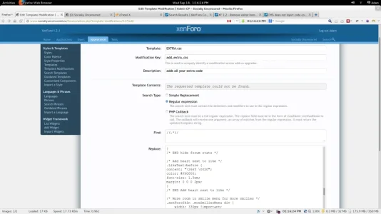

This is what I'm currently trying to apply
Screenshot from 2013-09-18 13:16:24.webp
Exactly what are you suggesting as an alternative?
As you're doing a regex, this is another method of replacing backreferences (from preg_replace). Use \\.
I don't think I can necessarily change this behavior due to backwards compatibility.
I solved this.
You were talking about my code. Your "hint" was so vague I kept thinking you were suggesting about the code used in the "find" box.
I have now documented that backslashes should be escaped in the replacement content if using a regular expression match.
