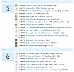

I ask for this because Jaxel's excellent xenAtendo events/calendar add-on connects an event to a new thread, but brilliantly pulls in the info from both the 'Event' title & 'Town & Postcode' [State/ZIP code] fields to create the thread title, which is causing a wee bit of a problem, as explained in THIS POST.

So, it may work for events created in xenAtendo, as that doesn't appear to limit what you can type in the event title field [yet] and then pulls in the town/postcode field as part of the associated thread's title.
Sorry, I know you don't support add-ons, but apart from a possible problem with editing titles [which I can check out] would is cause any other problems within xenForo?

This is only causing me a problem with events, as the add-on pulls in the town & postcode [and indeed the date in thread view] as part of the associated thread title, which is perfectly logical and makes the calendar view perfect in my mind.
If I can just change the limit to 150, without breaking anything in xenForo, whilst the limit of typing thread titles remain at 100 in xenforo and hopefully Jaxel can make that the limit for typing a event title, that would be perfect – as the town/postcode field is not going to break the extra 50 when it’s pulled in.
