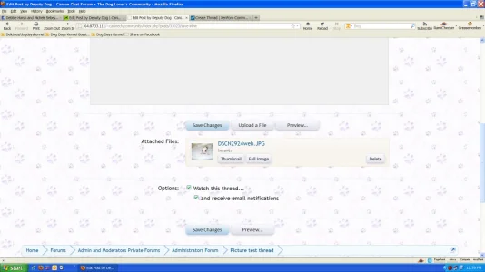

Here's my issue. I just migrated a recently purchased website from one server to another. Apparently one or two fairly minor items broke in the transition. Here is a screen shot of "Upload Attached Files" dialog box on my old server:
and here is how the same page looks on my new server after the migration:
As you can see, the "Thumbnail & Full Image buttons and the small preview of the file are missing in action . Any help or instruction to resolve this issue is greatly appreciated. Remember, xenForo is new to me so please explain any suggestions in layman's terms!

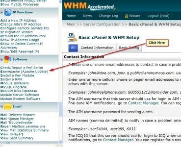

Log into CPanel WHM. Scroll down the left hand side option bar and find the Software Module. Click to open Easy Apache (Apachee Update).

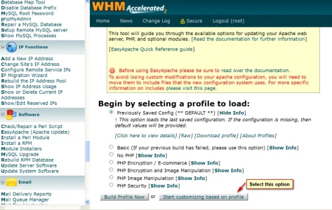

Next page will load the update selections. Select as shown below:
Next click on the Start customizing based on profile tab:
The graphic above does not show it, but there should be a green dot in the PHP Image Manipulation selection.

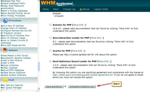

After you have selected the above option, you will need to select "Next" at the bottom of the next 3 pages to get to this page. Select as indicated. Do not make any other changes unless you are familiar with the functions:

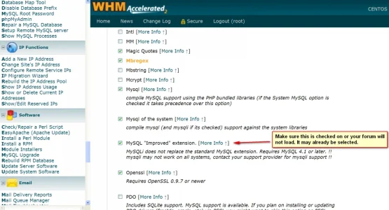

Scroll down the the page until you see the following. Be sure that the MySQL "Improved" extension is checked or your forum will not load once the rebuild is complete:

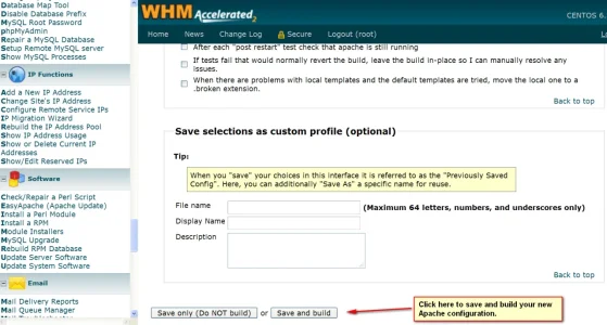

Next, scroll down to the bottom of the page and click save and build:
Once you click save and build, you will get a warning that advises you not to interrupt the build. If you do interrupt it, your server will not be accessible and your host will have to reload CPanel. All data will be lost. Do not interrupt the build! It will finish reconfiguring in about 5 minutes and you will get an onscreen message that Apache has been reconfigured.
If your issue was due to PHP Image Manipulation not being selected, you will now see your images on your forum.
