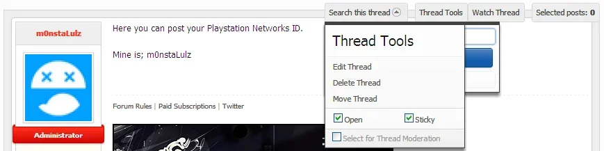

Okay so today I made a template mod "search this thread in thread" (Havn't posted yet). I think it will work, except there is one problem. The thread_view looks messed up when I put the template there.

Also when I do search on it, I get this:
Security error occurred. Please press back, refresh the page, and try again.
Any suggestions?
Jake Bunce
XenForo moderator
Staff member
#2
Each menu (search and thread tools) needs to be in its own "Popup" div:
<div class="Popup">
</div>
If they share the same Popup div then both menus will open like in your picture.
And the form action should use xen:link syntax:
<form action="{xen:link 'search/search'}" method="post">
For the security error try adding the curlies:
<input type="hidden" name="_xfToken" value="{$visitor.csrf_token_page}" />
