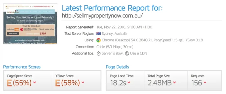

Example.
I Googled "sell my home" and ran the below through GTMetrix. A responsive real estate website with poor desktop loading time, let alone a mobile will only be much worse.
That is to demonstrate that responsive has nothing to do with performance. An AMP page is usually around 1 - 2 seconds fully loaded. Why? Because you're not allowed to use anything but AMP structure... so if it isn't important for the user, it isn't delivered to them.
