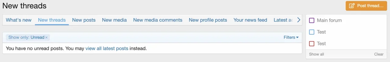

I enabled them all, singly and together, and it was still a no-show on New Threads under What's New. You can see here where it's trying to display on the sidebar: it pushes the Post Thread button all the way to the right of the page, but underneath is just blank space....

The filter bar appears to be missing. Do you have another add-on or a template change/modification that removes this?
It should look like this:
190575
Can't think of anything, but I guess I can try disabling all my other addon's. Whatever it is is only affecting New Threads, because it displays just fine on New Posts. Thanks
What version of XenForo are you running?
Okay, sorry for the run around, I should have been checking the error log instead of being so focused elsewhere. I found the culprit. It's a conflict with Stuart Wright's addon here:
Hopefully you guys can touch base on whatever the problem is. Here's some errors generated:
  • LogicException: Macro public:whats_new_posts :: filter_bar() error: Macro argument threadPrefixes is required and no value was provided

As soon as I disable that addon, your widget appears on New Threads.

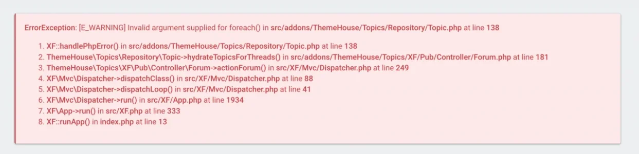

I'm having this issue, whenever I click to 2nd or 3rd ... page in a sub-forum. Please have a check.
ErrorException: [E_WARNING] Invalid argument supplied for foreach() in src/addons/ThemeHouse/Topics/Repository/Topic.php at line 138
    XF::handlePhpError() in src/addons/ThemeHouse/Topics/Repository/Topic.php at line 138
    ThemeHouse\Topics\Repository\Topic->hydrateTopicsForThreads() in src/addons/ThemeHouse/Topics/XF/Pub/Controller/Forum.php at line 181
    ThemeHouse\Topics\XF\Pub\Controller\Forum->actionForum() in src/XF/Mvc/Dispatcher.php at line 249
    XF\Mvc\Dispatcher->dispatchClass() in src/XF/Mvc/Dispatcher.php at line 88
    XF\Mvc\Dispatcher->dispatchLoop() in src/XF/Mvc/Dispatcher.php at line 41
    XF\Mvc\Dispatcher->run() in src/XF/App.php at line 1934
    XF\App->run() in src/XF.php at line 333
    XF::runApp() in index.php at line 13
I've went ahead and reported this on our issue tracker! :) We'll take a closer look into it.
