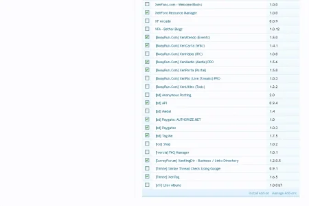

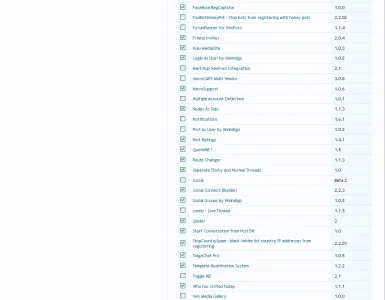

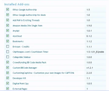

@masterchief I'm unable to reproduce. This seems to be an example of where two add-ons don't work well together, but probably it is a third completely unrelated add-on that is causing the conflict. I will need to investigate further. Are you able to send me the list (i.e., a screenshot of your ACP, by PM if you like) of all the add-ons that you have installed?
I will send to you... three pages of addons
