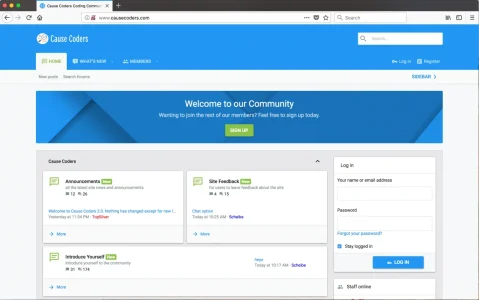

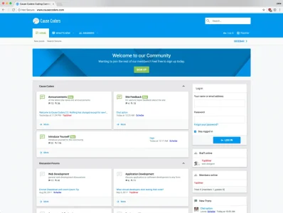

@Jake B.
That's the style where it's activated and nothing shows up. I just cleared my browser cache to see if that would help and nothing changed. I'm on Windows 10. I'm also using the new firefox browser, the latest version and it doesn't work on chrome either I tried it.
That's interesting, it seems to be working for me on both Chrome and FF
I do see that you're using CloudFlare, however. Could you try purging your CloudFlare cache to see if that resolves the issue?
