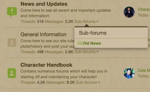

Custom icons don't appear in the subforum list, the default icon continues to display there - this is true even if a custom icon is set specifically for that forum.
Could this be rectified?
We currently have an issue created within our GitHub Issue Tracker but no ETA of when it will be added to [TH] Nodes though.

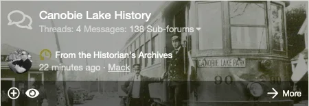

Would anyone know if there's something I can add to extra.less to replace "Threads" & "Messages" with Font Awesome icons?
Still wondering about this. Also, it looks like it reads, "138 Sub-forums," if you look at it quickly :ROFLMAO:
