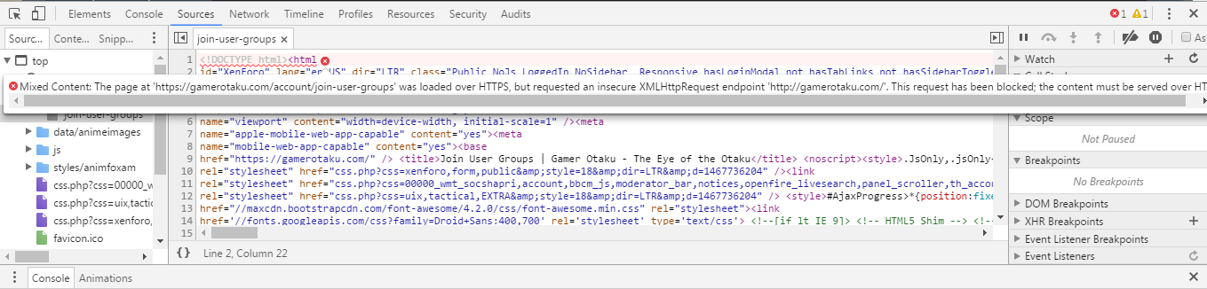

Also it looks like you're website is misconfigured to run the addon as it's attempting to request HTTP on a HTTPS website. You need to fix that for the overlay features to work properly.
Oh :| I used CloudFlare it's free and https is enabled. i'll talk out @suasive.
Thanks for help me @silence!
The issue may continue but first get that server misconfiguration sorted out and if it's still happening post here again :)
1# HTTPS is no issue with cloudflare.
XMLHttpRequest
Mixed Content: The page at 'https://gamerotaku.com/account/join-user-groups' was loaded over HTTPS, but requested an insecure XMLHttpRequest endpoint 'http://gamerotaku.com/'. This request has been blocked; the content must be served over HTTPS.
2# It's missed code.
Attempted to call XenForo. OverlayLoader.show() for %s before overlay is created
XMLHttpRequest

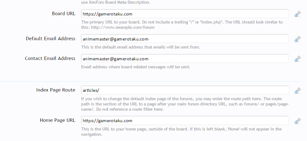

Did you change your site URL in the XenForo options to be using HTTPS?
Also it's not missing code, it's just not being processed as that mixed content error is preventing the overlay from appearing but XenForo thinks it's already appearing.

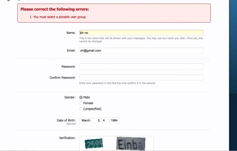

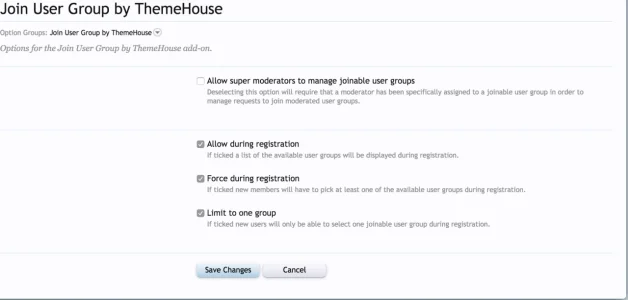

I have "force at registration" yet when I go to register there is no option there!
But at the same time it wont even let me register because it says I have to join a group :(
@ThemeHouse
What am I doing wrong??
