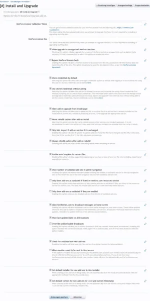

I would give it a new chance, after waindigo (Jon) is gone from this. I installed it fresh in my xenForo 1.5.1 and then I set it like you can see here:
After that, I run the cron manualy for first time... and nothing.
Minimum the Resource Manager is outdated, but no notice to make a update for this or other add-ons.
What doing wrong? Can any body help, please? :)

That broadcast is likely just remaining from an old version. You can ignore this (or turn off broadcasts in your options).
This is only able to check for updates to add-ons in the XenForo Resource Manager (or resource manager on another site). Unfortunately, it does not support XenForo's Resource Manager or Media Gallery currently.
As for the other add-ons, in your add-on list if you hover on the options dropdown you'll see an option that says 'Edit URL'. Just click that and set the link to the main resource page, for example you would use https://xenforo.com/community/resources/install-and-upgrade.2035 for this add-on.
Ok, than it works the same way as the other similar add-on from Chris D. ... Oh, i have now 60 URLs to edit. Yeaha...
If you install them from the resource manager using the add-on it will save the URL. There is, unfortunately, no way to figure out the URL automatically any other way.
