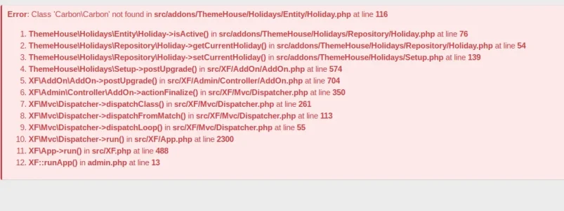

Just upgraded a few minutes ago and im getting this error:
eta: I'm upgrading from most recent version to this newer version.
Thanks
