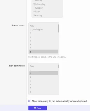

I only did 1am because of daylight savings time. Half of the year it would run at 00, the rest at 01.
Nice. Can you enlighten me on how and where to change this?
Is that only a question of changing the "any" to 0 or 1 in the "run at hours" of the Holiday cron like here:
https://www.domain.com/admin.php?cron/th_updateCurrent_holidays/edit
Can't edit it there, is all greyed out.
Make a copy of this cron.
Then disable the original cron.
Sorry I gave confusing advice. I actually have it set to run at 6:01am GMT time, which is 1:01am my time.

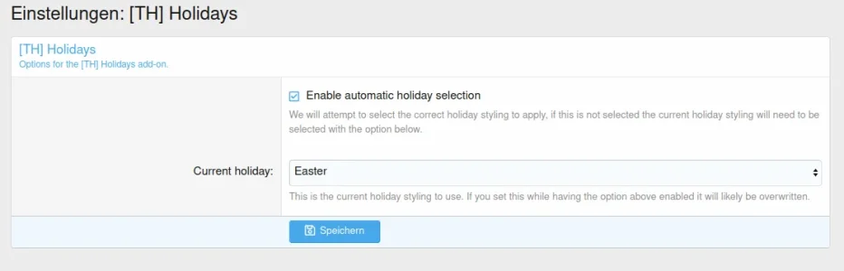

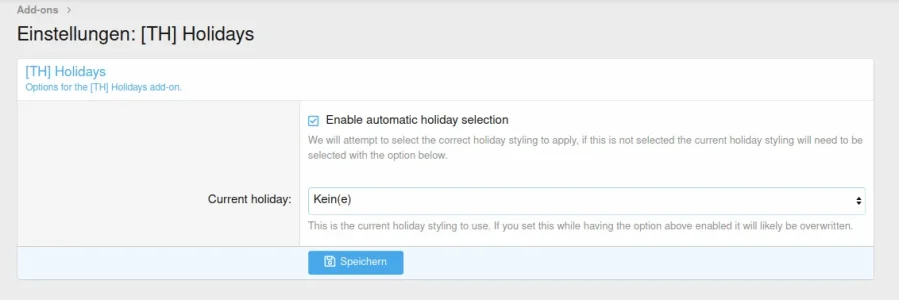

LOL. Now I have a problem with Easter.
The Easter design won't go away.
Even if I set it to "none" by hand.
The next day Easter is on again.

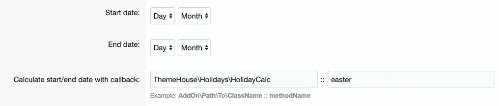

Yea the holidaycalc does that for several holidays, doing them for a week. (in some cultures, I guess some holidays are celebrated for a week) The dates also vary sometimes for Orthodox cultures (orthodox Christmas is about Jan 7th, Orthdox Easter is April 16, etc) The program often spans all the days from one to the other.
The Easter one is based on Orthodox Easter I believe, if you edit the settings for the Easter holiday entry and remove the callback class values, you can set custom dates to enable it.
Yes I had the same issue. It only went away when I just disabled it with the enable/disable switch for easter itself.

No files to edit, you can just edit the holiday settings at ACP > Appearance > Holidays and remove the callback values and set the dates you want:
But so you have to adjust the date every year.
That won't work. I had this as start day april 9th and end date 11 th, but it started at the 8th and did not end at all, so unfortunately that does not work.
Not really sure what you mean, if you set specific dates then it'll work like any of the other holidays like Christmas and New Year. If the callback is set then it uses that. If it's starting on the 8th then you probably have an issue with the timezone it's using, it sets it to use the board's default timezone.
I'm not sure whats unclear about that. You gave a screenshot. And it does not work like you say, at least not for eastern.
For Christmas and New Year, yes it does, for Eastern, no it does not, but I don't kow why. As said, I had it setup like that exactly with date 9 <->4 to start and 11<->4 to end, but it started at the 8th and did not end anymore, at least not on the 10th or 11th.
Edit: And no, my timezone is correct, it's set to UTC+1 which is correct. If the timezone would be wrong, all the holidays would be starting on odd days. We do have daylight savings in effect now, but that should only in worst case differ 1 hour, not 1 day.
The point is that if you've set manual dates and removed the callback values, the fact it's Easter is irrelevant, it doesn't know what "Easter" is, it's just two dates. So if you're setting dates, and removing the callback values, and it's activating on a different date, then it sounds like the default board timezone is wrong.
Ah sorry, I was checking your screenshot. So I would have to remove the callback there. Yes indeed, but then I have to set it manually every year. Should not be needed really with php.
I did not had remove the callback in the lines below, so that must have been the reason of not working then.
