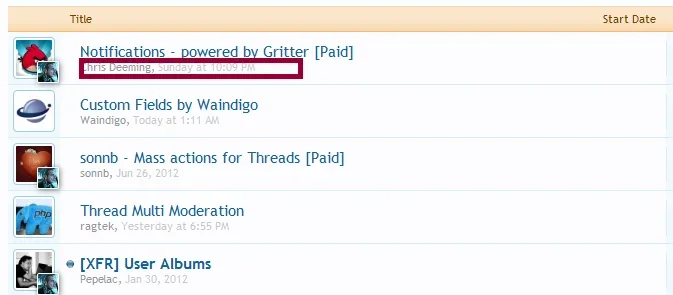

This is something that I wanted for very long, good stuff as always :) Jon, is it possible with this addon now to add extra fields under the thread title like this one?
