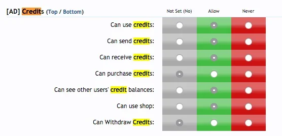

- It does not work as it is. I have set the permission and I see that all of them have been set well. I have tested to post a 85 words in a post, and nothing happens. No credit added to my account. Permission have been set.

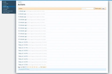

- Activity log has been stuck. Our members post and make thread. The activity log has not changed.

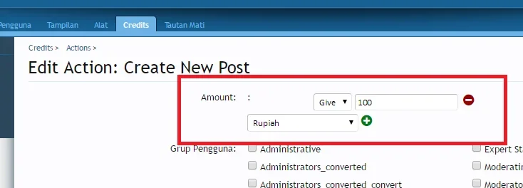

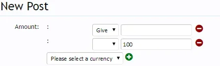

- Problems #1 and #2 could have happened because every time I set the currency to "Rupiah" (my custom currency that I have made), and saved it, when I go back to the action details it appears as not set. So basically we can't set the currency on every actions. Every time we save the setting it will go back as not set for the currency. Please see attachments below.
I want to set the actions vs currency like this:
And then I save it. And then when I re-open the actions, this happened:
I believe it does get broken and is some bug? The currency settings not stick there, when we re-open it gets blanks and currency not selected

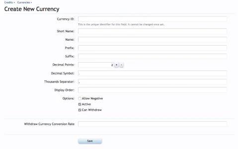

- Problems #4, when I want to allow withdraw for a currency (I have set the conversion rate), and want to save the changes, it counters:
Mysqli statement execute error : Out of range value for column 'withdraw_conversion_rate' at row 1
Zend_Db_Statement_Mysqli->_execute() in Zend/Db/Statement.php at line 297
Zend_Db_Statement->execute() in Zend/Db/Adapter/Abstract.php at line 479
Zend_Db_Adapter_Abstract->query() in Zend/Db/Adapter/Abstract.php at line 632
Zend_Db_Adapter_Abstract->update() in XenForo/DataWriter.php at line 1654
XenForo_DataWriter->_update() in XenForo/DataWriter.php at line 1623
XenForo_DataWriter->_save() in XenForo/DataWriter.php at line 1419
XenForo_DataWriter->save() in Audentio/Credit/Core/ControllerAdmin/Currency.php at line 91
Audentio_Credit_Core_ControllerAdmin_Currency->actionSave() in XenForo/FrontController.php at line 351
XenForo_FrontController->dispatch() in XenForo/FrontController.php at line 134
XenForo_FrontController->run() in /home/kebunpedia/public_html/admin.php at line 13
