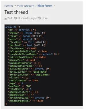

It looks like this might be what I'm after: https://xenforo.com/community/resou...ositions-navigation-entries-and-widgets.8041/
Thanks.
It is definitely possible to print out the vars available to a template and utilise them for customisation.
The guide you linked to explains how to do that in detail.
For example:
