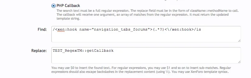

I think your best bet is to use a PHP Callback on the template modification.
You would set it up like this:
Then the code like this:

This method works well for the initial loading of the page, but if I were to update my option value, the changes would not be reflected until I re-built "Master Data" (where the change would then be shown as expected). If I completely empty my callback, the TM is shown regardless (until I "rebuild").
Ideally, if one of my options has changed, the "navigation" template could be rebuilt (or just emptied?), ready to use the callback when the page is next loaded.
Yes, you would be able to trigger some sort of rebuild by using the Option verification call back.
That'd allow you to run some PHP code when the option value changes.
The code would be basically this:
PHP:
        $templateModel = $this->_getTemplateModel();
        $templates = $templateModel->getTemplatesByTitles(array('navigation'));
        foreach ($templates AS $template)
            $templateModel->reparseTemplate($template, true);
My problem now is, it seems the template is reparsed before the settings are saved (leading to my changes to be one step behind what I would expect). You have to save, then save again with a different option, to get the previous one to take effect.
Yeah I can understand that. Effectively the verification runs before save, so you're right: the option doesn't take effect.
I still think this is the best way to do the conditionals that you want in that template. But then the only way I can think to get around rebuilding the template is:
1) The verification callback, despite the process of changing the option value is already happening, could actually update the option value using a DB query. Effectively the value will be getting set twice, but if it is set by a query you could immediately afterwards reparse the template. It would work but... a bit messy really.
2) Forget the verification call back and extend the Option DataWriter. Extend the _postSave function. If the option ID == your option, and option_value is changed, perform the template reparse.
Thanks again. I'm using the second option, but I'm still having trouble getting the navigation to update when the options are changed (or, even just when the options are saved to verify it's working). It still takes a second "Save" in order for it to work.
I'm using the "reparseTemplate", like you suggested, in my extended DataWriter_Option, but I noticed there was a similar function "removeTemplateFromCache", which may (or may not) be more useful. (Maybe they effectively do the same thing?)
I think it doesn't work until a second "Save" because if I reparse the template in postSave... well, I just think that's no good on it's own. But I think removing the template from the cache would.
Thoughts? :)
This code:
PHP:
Is basically the code that executes after a template modification is saved. So I'd have thought that would do it.
Only thing I can think of is to change the function you're extending in the DW from _postSave to _postSaveAfterTransaction
That would then reparse the template after the option value change has been committed to the database.
I got this working by extending actionList() in ControllerAdmin_Option.
I don't know if it's best practice, but it works, at least for the time being. Thanks for your help with this one. :)
