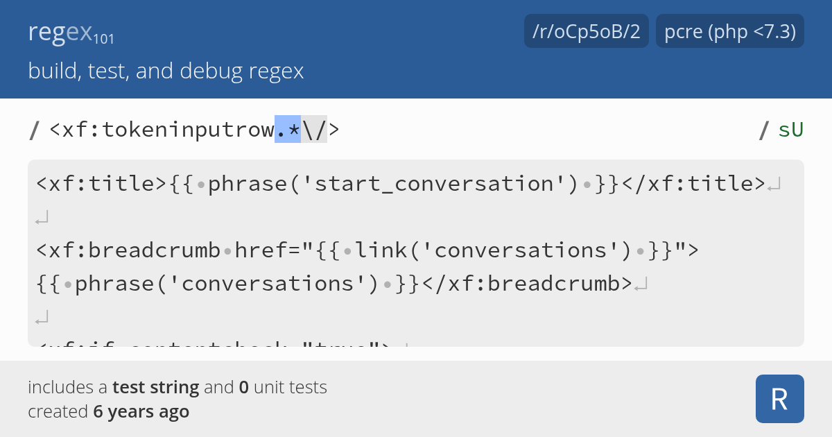

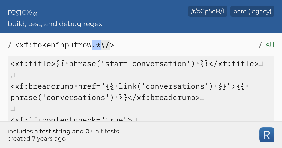

Heh, I actually just responded to your PM about this, but for everyone's benefit, I came to the same answer as @Kirby and you can actually do this one fairly elegantly so it works with both versions.
XF 2.1.2:
XF 2.1.3:
