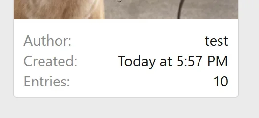

And it would also be more conventional if the answer values of Created by (Author maybe?), Created on (Creation date maybe?) and Total posts were displayed aligned to the right, like resource infos. (It's a very small detail but the titles mentioned above should be dimmed in color).
Perhaps you should also use a name specific to blogs for the "Posts", in general we speak of "Blog entry" or perhaps even "Blog article", it would be less confusing with the "Posts" which correspond more to thread replies. This is manageable by everyone with the phrases but I specify it for all purposes.
Everything here has been fixed, thanks to you graciously, besides the header_image distortion. I haven't figured out a proper way to stretch the images perfectly due to not having any limitations (size and width/height) on the xf:uploadrow being used for it and not figuring out yet how to implement them.

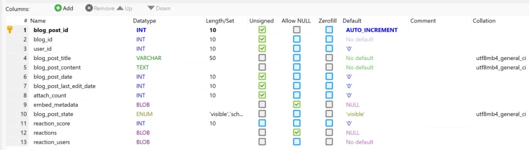

I'm unsure why but I think on your install it skipped creating the last table, view_count in this case, on installStep2. On another new fresh install as of 2 minutes ago it installed it for me locally so really not sure why it skipped for you.
If you have this on a test install would you mind attempting a reinstall of the addon to see if it misses that column again for you?
[TaylorJ] Blogs 1.0.0 Beta 4 - seems like a better version of the seldomly used "Profile Posting". Is it possible to "disable" profile posting and encourage people to use [TJ] Blogs
I would probably leave this up to forum owners to decide if they'd like to keep both / blogs over profile posts, don't want to enforce my ideals too much onto the end users.
For this one, would you mind grabbing a screenshot of your database, specifically the entirety of the xf_taylorj_blogs_blog_post table and posting it here. I was not able to reproduce this one on a fresh 2.3.2 install.
In src/addons/TaylorJ/Blogs/Setup.php replace both lines 48 and 72 with the below
I miss the line 72, now it works well. (y)

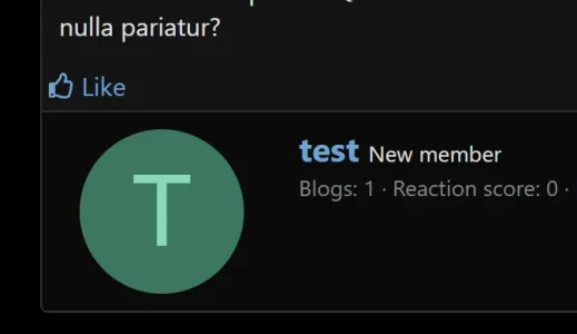

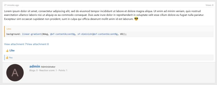

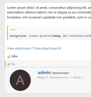

For info, i'm able to like my own blog entry.
And the reaction bar is displayed to the left corner instead the right corner, but it's detail.

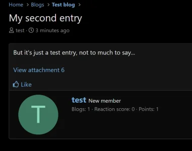

Attachment are not visible in blog view, but maybe it's as designed?
And it's a link in post view

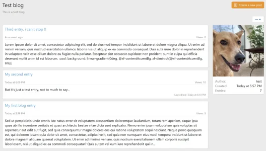

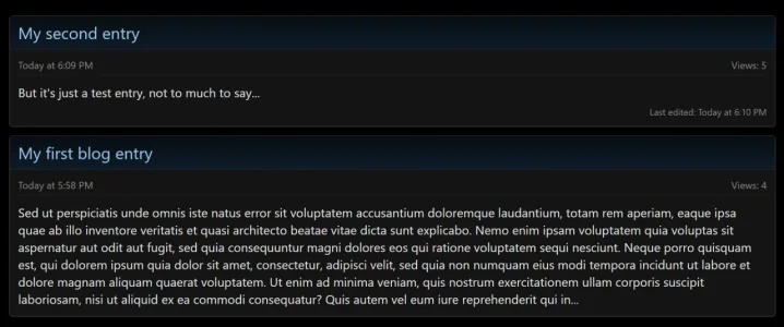

I think you're pretty busy with the PHP back-end, so if you don't mind I'll make suggestions for the HTML and Less front-end.
For the template taylorj_blogs_blog_view it would be wise to use the “cell” message structure, this allows for XF consistency.

HTML:
<xf:css src="taylorj_blogs_blog_view.less" />
<xf:breadcrumb source="$blog.getBreadcrumbs(true)" />
<xf:title>{$blog.blog_title}</xf:title>
<xf:description>{$blog.blog_description}</xf:description>
<div class="taylorjUserBlogs-blog-description">
<xf:pageaction>
    <xf:button href="{{ link('blogs/blog/add-post', $blog) }}" fa="fa-plus-square" class="button--cta">
        Create a new post
    </xf:button>
</xf:pageaction>
<xf:if contentcheck="true">
    <div class="u-pullRight buttonGroup-buttonWrapper">
        <xf:button class="button--link menuTrigger" data-xf-click="menu" aria-expanded="false" aria-haspopup="true"
            title="{{ phrase('more_options') }}">&#8226;&#8226;&#8226;</xf:button>
        <div class="menu" data-menu="menu" aria-hidden="true">
            <div class="menu-content">
                <h4 class="menu-header">{{ phrase('more_options') }}</h4>
                <xf:contentcheck>
                    <!--[XF:thread_tools_menu:top]-->
                    <xf:if is="$blog.canEdit()">
                        <a href="{{ link('blogs/blog/edit', $blog) }}" class="menu-linkRow">{{
                            phrase('taylorj_blogs_blog_edit') }}</a>
                    </xf:if>
                    <xf:if is="$blog.canDelete()">
                        <a href="{{ link('blogs/blog/delete', $blog) }}" data-xf-click="overlay" class="menu-linkRow">{{
                            phrase('taylorj_blogs_blog_delete') }}</a>
                    </xf:if>
                    <!--[XF:thread_tools_menu:bottom]-->
                </xf:contentcheck>
            </div>
        </div>
    </div>
</xf:if>
</div>
<xf:css src="message.less" />
<div class="block taylorjUserBlogs-block">
    <div class="taylorjUserBlogs-blog-posts">
        <xf:foreach loop="{$blogPosts}" key="$blog_post_id" value="$blogPost">
        <div class="block-container">
            <a href="{{ link('blogs/post', $blogPost) }}">
                <h2 class="block-header">{$blogPost.blog_post_title}</h2>
            </a>

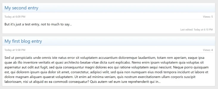

            <div class="message">
                <div class="message-inner">
                    <div class="message-cell message-cell--main">
                        <div class="message-attribution">
                            <xf:date time="$blogPost.blog_post_date" />
                            <div class="u-pullRight">
                                {{ phrase('views') }}: {$blogPost.view_count}
                            </div>
                        </div>
                        <div class="message-content">
                            <div class="message-body">
                                {{ snippet($blogPost.blog_post_content, 750, {
                                    'stripQuote': true,
                                    'bbWrapper': true
                            </div>
                        </div>
                        <xf:if is="$blogPost.blog_post_last_edit_date">
                            <div class="message-lastEdit">
                                {{ phrase('last_edited:') }} <xf:date time="$blogPost.blog_post_last_edit_date" />
                            </div>
                        </xf:if>
                    </div>
                </div>
            </div>
        </div>
        </xf:foreach>
        <xf:pagenav page="{$page}" perpage="{$perPage}" total="{$total}"
            link="blogs/blog/" data="{$blogPost}" wrapperclass="block-outer block-outer--after" />
    </div>
    <div class="taylorjUserBlogs-blog-details">
        <div class="taylorjBlogs-blog-header-image">
            <img src="{$blog.blog_header_image}" alt="Header Image" />
        </div>
        <div class="taylorJUserBlogs-details-text">
            <dl class="pairs pairs--justified">
                <dt>{{ phrase('author') }}</dt>
                <dd>{$blog.User.username}</dd>
            </dl>
                <dt>{{ phrase('created') }}</dt>
                <dd><xf:date time="$blog.blog_creation_date" /></dd>
            </dl>
                <dt>Entries</dt>
                <dd>{$blogPost.Blog.blog_post_count|number}</dd>
            </dl>
        </div>
    </div>
</div>
I used the XF syntax too for the blog description as you can see:
This involves a small change in taylorj_blogs_blog_view.less:
Less:
.taylorjUserBlogs-blog-description {
    padding-bottom: 40px;
    //color: @xf-textColorDimmed;
I enjoy playing with the code a bit, you do what you want with my suggestions, they can be thrown in the trash, no offense here.

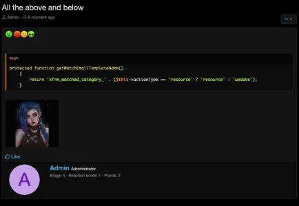

Styling is currently in the works for reacts to make them fit better (like regular articles) and also working on not allowing to react to own blog posts.
For the blog view the no attachments on the blog posts list is intentional for now, I could probably be persuaded to change it to show them as I was pretty 50/50 on to or to not.
Hmmm I thought I had thumbnails working, I'll take a look now.
            </a>
                            </div>
                        </div>
                                    'stripQuote': true,
                                    'bbWrapper': true
                            </div>
                        </div>
                            </div>
                        </xf:if>
                    </div>
                </div>
            </div>
        </div>
        </xf:foreach>
    </div>
        </div>
            </dl>
            </dl>
                <dt>Entries</dt>
            </dl>
        </div>
    </div>
</div>
Less:
Implemented thank you!
I just tried minorHeader instead Header for blog posts, that's not bad, maybe something you can think about.
The render is lighter, cleaner, imho.
XF 2.3
I tried to post emoji and code and they are not rendered in blog view.
XF 2.3
Oh that does look nice, I'll give it a better look now.
Also strange update on the thumbnails and emoji/code bbcode not showing up. They are for me and I can't tell why...
Edit: OHHHH you said blog view for emoji and code, that's probably due to the snippet I'll check.
Blog post view, yes, bbcode and emoji are showing well, but not thumbnail on my side. I will look into it more precisely.
But bbcode and emoji are not rendered in blog view
You can use the same structure i used for blog_view template
HTML:
<xf:css src="taylorj_blogs_blog_post_view.less" />
<xf:breadcrumb source="$blogPost.getBreadcrumbs(true)" />
<xf:title>{$blogPost.blog_post_title}</xf:title>
<xf:description meta="false">
    <div class="u-pullLeft">
        <ul class="listInline listInline--bullet">
            <li>
                <xf:fa icon="fa-user" title="{{ phrase('thread_starter')|for_attr }}" />
                <span class="u-srOnly">{{ phrase('thread_starter') }}</span>
                <xf:username user="{$blogPost.User}" class="u-concealed" />
            </li>
            <li>
                <xf:fa icon="fa-clock" title="{{ phrase('start_date')|for_attr }}" />
                <span class="u-srOnly">{{ phrase('start_date') }}</span>
                <a href="{{ link('blogs/post', $blogPost) }}" class="u-concealed">
                    <xf:date time="{$blogPost.blog_post_date}" />
                </a>
            </li>
        </ul>
    </div>
                    <xf:contentcheck>
                        <xf:if is="$blogPost.canEdit()">
                            <a href="{{ link('blogs/post/edit', $blogPost) }}" class="menu-linkRow">{{
                                phrase('taylorj_blogs_blog_post_edit') }}</a>
                        </xf:if>
                        <xf:if is="$blogPost.canDelete()">
                            <a href="{{ link('blogs/post/delete', $blogPost) }}" data-xf-click="overlay"
                                phrase('taylorj_blogs_blog_post_delete') }}</a>
                        </xf:if>
                    </xf:contentcheck>
                </div>
            </div>
        </div>
    </xf:if>
</xf:description>
<div class="block">
                            </div>
                        </div>
                                {{ bb_code($blogPost.blog_post_content, 'blog_post_id', $blogPost) }}
                            </div>
                            <xf:react content="{$blogPost}" link="blogs/post/react" list="< .taylorJUserBlogs-post-content | .js-reactionList" />
                            <div class="reactionsBar js-reactionList {{ $blogPost.reactions ? 'is-active' : ''}}">
                                <xf:if is="$blogPost.reactions">
                                    <xf:reactions content="{$blogPost}" link="blogs/post/reactions" />
                                </xf:if>
                            </div>
                        </div>
                    </div>
            </div>
        </div>
        <aside class="message-articleUserInfo">
            <div class="message-cell">
                <div class="contentRow">
                    <div class="contentRow-figure">
                        <xf:avatar user="$blogPost.User" size="m" />
                    </div>
                    <div class="contentRow-main">
                        <div class="message-articleUserFirstLine">
                            <div class="message-articleWrittenBy u-srOnly">{{ phrase('article_written_by') }}</div>
                            <h3 class="message-articleUserName">
                                <xf:username user="$blogPost.User" rich="true" />
                            </h3>
                                <div class="message-articleUserBlurb">
                                    <xf:contentcheck>
                                        <xf:userblurb user="$blogPost.User" tag="div" />
                                    </xf:contentcheck>
                                </div>
                            </xf:if>
                        </div>
                            <div class="message-articleUserAbout">
                                <xf:contentcheck>
                                    <xf:if is="$blogPost.User.Profile.about != ''">
                                        {{ bb_code($blogPost.User.Profile.about, 'user:about', $blogPost.User) }}
                                    </xf:if>
                                </xf:contentcheck>
                            </div>
                        </xf:if>
                            <div class="message-articleUserBanners">
                                <xf:contentcheck>
                                    <xf:userbanners user="$user" />
                                </xf:contentcheck>
                            </div>
                        </xf:if>
                        <div class="message-articleUserStats">
                                <!--[XF:stats:start]-->
                                <li>
                                    <dl class="pairs pairs--inline">
                                        <dt>{{ phrase('taylorj_blogs_blogs_total') }}</dt>
                                        <dd>{$blogPost.User.taylorj_blogs_blog_count|number}</dd>
                                    </dl>
                                </li>
                                <!--[XF:stats:after_messages]-->
                                <li>
                                        <dt>{{ phrase('reaction_score') }}</dt>
                                        <dd>{$blogPost.User.reaction_score|number}</dd>
                                    </dl>
                                </li>
                                <!--[XF:stats:after_likes]-->
                                <!--[XF:stats:after_reactions]-->
                                <xf:if is="$xf.options.enableTrophies">
                                    <li>
                                            <dt>{{ phrase('points') }}</dt>
                                            <dd>{$blogPost.User.trophy_points|number}</dd>
                                        </dl>
                                    </li>
                                </xf:if>
                                <!--[XF:stats:end]-->
                            </ul>
                        </div>
                    </div>
                </div>
            </div>
        </aside>
    </div>
</div>
XF 2.3
Each time I edit a blog post it increases the number of posts.
I just have 3 posts/entries
