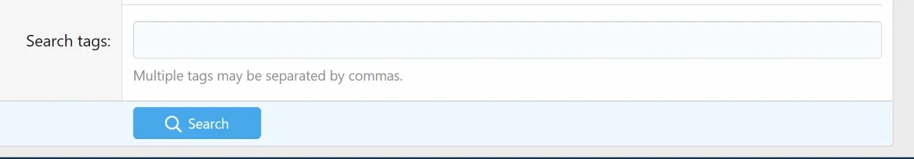

Looks like that your addon adds a second form_field in the threads batch part of the acp; now the search doesnt work for tags.

Try
/admin.php?threads/batch-update
Maybe you will find the form-field "tags" two times. If i deactivate your addon, the second field at the end disappears.
Maybe i have a problem with another addon, maybe it is your addon. I cant test it now.
Try
I only have one field. What other tag related addons do you have?
I can confirm the same as Robert9, it's coming from an admin template modification in Tag Essentials (helper_thread_search_criteria). When enabled it adds a new "Search tags" search field to the bottom of the batch update threads screen resulting in two 'tags' search fields, the stock one near the top and and a second one near the bottom.
I haven't looked at the code yet but from a quick test the Tag Essentials input seems to give the same results as the stock field.
XF Stock option (near the top of the bulk threads screen)
ES added option (at the bottom of the bulk threads screen)
This would imply that stock XF added the Search Tags field near the top after tag essentials was created.
This is one for @Xon to have a look at and remove the tag search field added by the addon.
