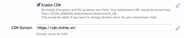

Is there still a chance that the media gallery will add a CDN field like the example below ?
The gallery stores its images in the attachment system, therefore considerations for a CDN would be more of a core XF feature than a separate XFMG feature. I believe there are various suggestions related to CDN integration. There may also be add-ons that extend XF to provide CDN functionality. [bd] Attachment Store is compatible with XFMG for example.

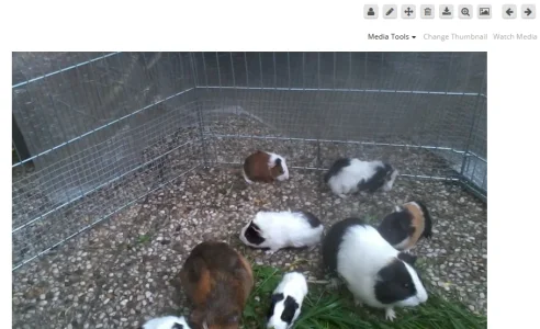

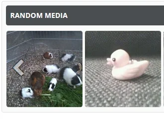

Can it be that the problem is that the images of XFMG be stored in a different location than all other attachments of the forum? Because those are stored oke on the CDN servers.
