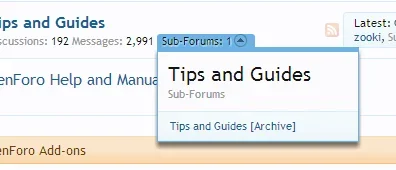

Steve F
This has always kinda bugged me but I kept forgetting to post :p
Current subForumsPopup
Looks ok this way

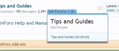

.subForumsPopup .PopupControl.PopupOpen
    background: @primaryLight;
Or

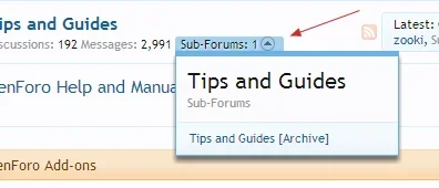

Still use the image but move it to the bottom, which looks a bit better imo.
    background: @primaryLight url('@imagePath/xenforo/gradients/tab-unselected-25px-light.png') repeat-x bottom;
Agreed. Nice spot Steve. :thumbsup:
Either one of your solutions is good but setting the gradient to bottom would be my choice personally.

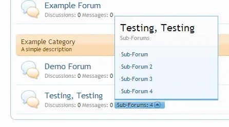

With the image at the bottom, you'll have the opposite problem when the popup is above the control.
True, although I don't see it as much. The image at the bottom still looks better than the current setting though.
On a side note, some margin-top for the BottomControl would also help that area.
