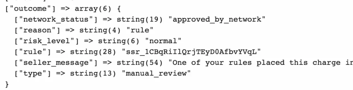

Just so I'm on the right page, could you please provide an example of the received webhook? At least an excerpt of the part which indicates it is held.
Yeah, the charge.succeded event has an outcome.type field of manual_review (it also has a non-empty review field):

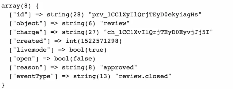

A review event is then sent after the review is dealt with:
