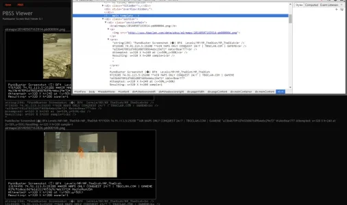

Is what I am getting and yes its still not showing. So here is a screen shot of trying all of these:
{$text}
{xen:string nl2br, $text}
{xen:helper dump, {xen:string nl2br, $text}}
{xen:raw $text}
Shot:
The first 2 are the ones not displaying the last 2 are displaying.
Okay quick update, put the nl2br into the php thats returning the text it is now formatting the {xen:raw $text}, Im pretty sure I can work with that.
Is it weird the first 2 not working though?
It is slightly weird, but the interesting thing is the third one shows that the nl2br is working perfectly. Notice the <br /> at the end of each line. On the basis of the second one, in theory, this should work:
{xen: raw {xen:string nl2br, $text}}
Alright thanks, I believe you are correct on that theory. I appreciate your time I know you are a busy man.
