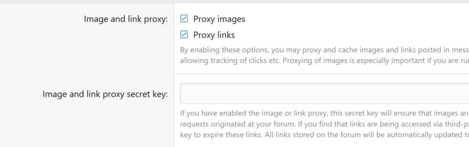

Probably best to get a new IP assigned to your account. But before doing that make sure that you are not leaking your IP through any route (link/image proxy, unfurl).
Is the proxy secret key provided by a third-party service or you have to create it by yourself?
yeah it's kind of confusing. xenforo devs should provide a random key generator here similar to how wordpress provides here. (Or maybe add a line in the field description that a key can be any random mix of numbers and letters 🤷‍♂️ )
from my experience you are supposed to enter any random keywords here. i just use a random password generator and put in that.
but this is not what hides your IP. this one is used to create randomized URLs for your proxied images which you can expire by changing the key.
It seems that protect from third-party access or i understand wrong?
If you have enabled the image or link proxy, this secret key will ensure that images and links are only proxied if the requests originated at your forum. If you find that links are being accessed via third-party sites, you can change this secret key to expire these links. All links stored on the forum will be automatically updated to use the new secret key.
I had also activated proxying with CF via the DigitalPoint add-on.
yeah. from my understanding, proxy was originally launched to host http images from external domains through your own domain which might be running on https. it fixed a major issue with mixed security content which caused issues in browser. now this is not that big of a deal coz most of the web is now basically running on https and you would rarely land on a domain on http.
the idea behind the key is to create expirable URLs for images. so, if some third party website starts embedding your hosted images using the proxy links, you can just change the proxy key and all those links would expire. but the same embeds would continue to work on your board because those links would get updated automatically.

As you wrote before maybe XF devs should explain better how it works.
It is like a 10 year old feature and there is a video that explains it lol.
This page could be improved I suppose.
Also this bit is incorrect:
Here, you can set parameters for your proxy, including how often your server will check for updates of the original source image and how large images can be before your site will opt to keep them hot-linked instead of proxying them.
XenForo 2.2/2.3 shows a placeholder image instead of hotlinking images which exceed custom size setting in backend. 🤷‍♂️
Or, you could just enter a random key instead of wasting development time.
